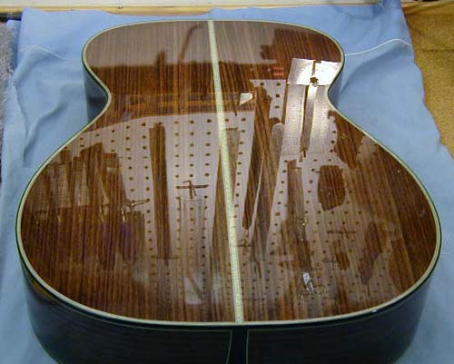

I've levelled/sanded and buffed out the KTM-9 finish on my instrument. After careful inspection of the surface (it passed!), I quit for the day. The next morning, I resume only to find several odd, curved lines perhaps 1/16" wide on the back’s finish. It looks like a finely blistered finish, but upon closer examination with a loupe, I'm somewhat certain that it's pitting, not blistering. The photo below is prior to buffing (the only good photo I have).
At first I thought that I could have missed the problems on the previous inspection. But, now I’m convinced that’s not the case. After a complete inspection in all kinds of lighting, more seem to be popping up in new places as I work on the instrument. The top has been immune, until yesterday that is, when several of those lines appeared there also (a couple of days after buffing). The sides don't show any of these marks - yet at least.
That got me to thinking ... the instrument has been mainly resting on the back, and rarely on the top the last several days. When not holding it during final sanding and buffing, it's been lying on the bench with a scrap of carpet on the benchtop, and an old (but laundered) sheet on top of the carpet. I also had a piece from the same sheet over the carpeted cauls of my body vise which I used when doing the sides.
Could somehow “something” invisible that can pit KTM-9 got deposited on the laundered sheets in the geometry of slightly curved lines about 1/16” wide? To me, it sounds a little far fetched. Does anyone know of a substance that might cause this on the KTM-9? Does KTM-9 react with DEET (though I have no clue on how lines of DEET would have become deposited on a laundered sheet)? Any suggestions on how to troubleshoot to help me figure this out so I can prevent it in the future?
Pete

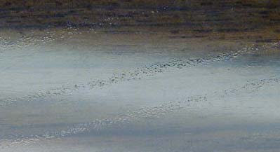

My first though while looking at the photo is that the patterns seam to be parallel an not at all random. I would think that this is either cause by something it was resting on or something it came into contact with that would leave a foot print matching the pattern. Is there any vinyl around where the guitar was?MichaelP38720.5926041667

1) The angles of the lines in general are random, though the ones in the photo are indeed parallel and at about 30 degrees to the grain. In other instances, they go across the grain as one or more lines, and in some places, with the grain. I did not see any correlation in the overall picture.
2) No vinyl around that I can think of. Would vinyl affect KTM-9 like it does nitro lacquer?
3) Pore filling was performed with ZPoxy 15 minute resin (all I could find in a pinch), and not the Finishing Resin most of you use. While I may have applied the epoxy at a slight angle, the squeegeeing off was done with the grain as that's what worked best for me.
4) The finish was brushed on with a foam brush. That went EXTREMELY well, in fact I was hard pressed to produce any bubbles at all. A sample of KTM-9 grafted coatings sent me a couple of years ago, was much more bubble prone, but that may have been the foam pads I was using to apply it to the relatively small test swatches.
Also, the finish was given a full month to cure before final levelling, sanding, and buffing. (3M Fre-Cut, StewMac Micro Finishing Abrasives, and Menzerna Fine followed by Glans Wachs).
Pete

The sheet that was used under the instrument to protect the finish did reside in a plastic shopping bag (Stop & Shop most likely) for many months prior to being cut up for the guitar. Is there any vinyl content in these shopping bags?
PostPosted: Tue Jan 03, 2006 7:06 am
Humm??!!!I have never finished over the Zpoxy adhisive resign before. It might be the problem
Are all the patches like the pic and in a consistant width. The pic looks kind of like wheel tracks. I do undersand that the patterning is not as consistantly paralle as the pic shows, but are all the patterns stipes like the picture shows?

About the only consistent thing is a slight curve to them. Some are single stripes, some are double, and some even have triple. Some are barely 2" long, others are 6" long. Some are very faint and narrow (1/32"?), others are more pronounced like in the photo. Those might be over 1/16" wide.
PostPosted: Tue Jan 03, 2006 7:48 am
I have been useing KTM-9 over shellac over Zpoxy finishing resin for over a year now. I have had no issues any where near like this. The fact that it is apearing in stripes leads me to believe that it is a contact contamination issue. Just what the contaminate is, without knowing all that the guitar may have had contact with is hard to say. My first instint would be to level, add two more coats level and see if it reappears. If you do this I ould hang the guitar durring cure and when not buffing. It has to be something it came in contact with.
PostPosted: Tue Jan 03, 2006 7:52 am
Posts: 183
Do you see any relationship between your foam brush technique and the directions of the lines? Perhaps the handle of the brush in the foam had a reaction with KTM9. Or if you did not use a new brush for every coat (not that I would either mind you...) perhaps what you used to clean the brush with remained in the foam.
I used two brushes of different sizes, and did reuse them for the whole job. Between coats, I just rinsed in warm running water until the runoff was clear. Kept the brushes in individual Zip-Loc bags when not using them.
Something interesting comes to mind ... I think I used the smaller brush for the sides, and the larger one for the top/back. So far, only the top/back has these marks. Hmmmmm.
But I still don't get why the surface would come out as it's supposed to and then develop these defects after an inspection verified the defects were not initially present. Could there be a mechanism in the finish which would allow contaminents trapped in the finish to cause damage after a buff-out with initially good results?

If possible, post a few more pictures as you mention they're more random areas as well. It may help give us a better idea or understanding of whats going on.
The picture supplied containing the bluish cast, would mean the coating was applied to heavily to fast or to many coats to fast without proper cure between. If 3mil wet was applied, it will leave 1.5mil - 1 hour under IR will definitely cure enough for next coat.
